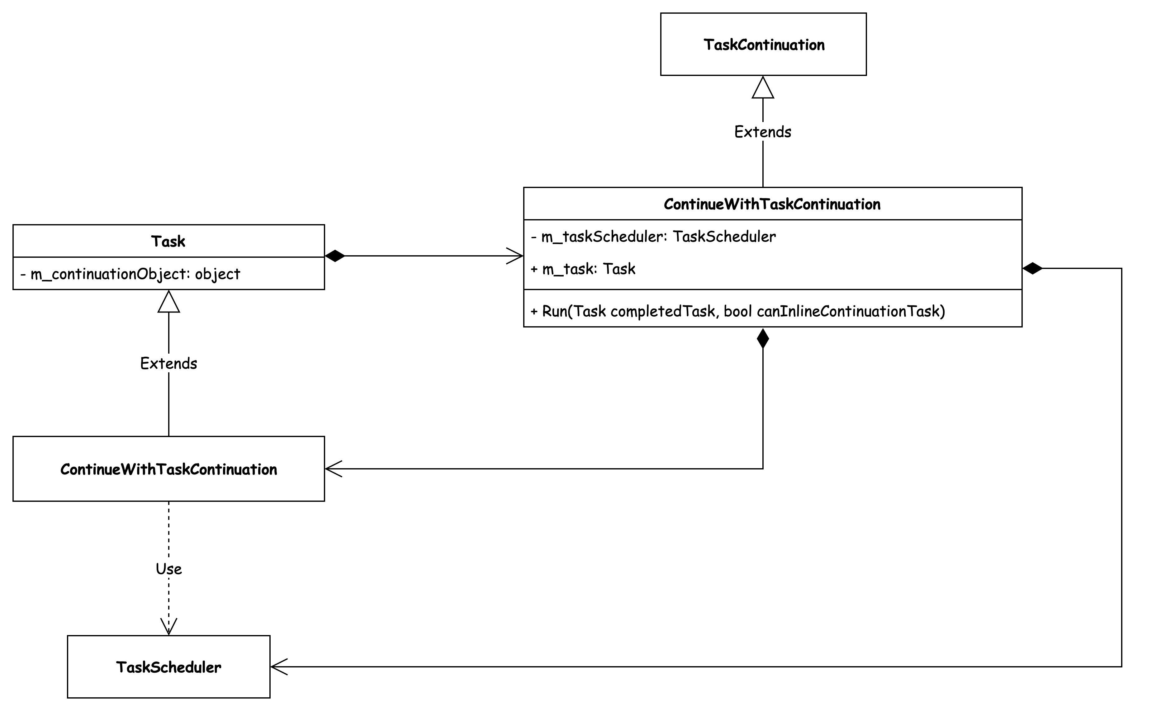

回调的容器:TaskContinuation
我们注意到 m_continuationObject 字段的类型是 object,而 object 类型在数据的存储上有更多的灵活性。
class Task
    // 保存一个或一组回调
    private volatile object m_continuationObject;
我们看下下面的代码
var antecedentTask = Task.Run(() =>
    Thread.Sleep(1000);
    Console.WriteLine("Antecedent Task Completed");
PrintContinuationObjectType(antecedentTask);
antecedentTask.ContinueWith(_ => Console.WriteLine("Continuation Task1 Completed"));
antecedentTask.ContinueWith(_ => Console.WriteLine("Continuation Task2 Completed"));
Console.ReadLine();
void PrintContinuationObjectType(Task task)
    var continuationObject = typeof(Task)
        .GetField("m_continuationObject",
            BindingFlags.NonPublic | BindingFlags.Instance)
        .GetValue(task);
    var type = continuationObject?.GetType().FullName ?? "null";
    if (continuationObject is IEnumerable enumerable)
        type += $", Element type: {enumerable.Cast<object>().First().GetType().FullName}";
    Console.WriteLine(type);
执行结果如下
null
System.Threading.Tasks.ContinueWithTaskContinuation
System.Collections.Generic.List`1[[System.Object, System.Private.CoreLib, >Version=6.0.0.0, Culture=neutral, PublicKeyToken=7cec85d7bea7798e]], Element type: >System.Threading.Tasks.ContinueWithTaskContinuation
随着回调函数注册数量的增加,m_continuationObject 保存的数据类型也在变化
  1. 没有注册时:null
  2. 一个回调时:ContinueWithTaskContinuation 实例
  3. 超过一个回调时:元素类型是 ContinueWithTaskContinuation 的 List<object>

ContinueWithTaskContinuation 的父类 TaskContinuation 是一个抽象类。除了 ContinueWithTaskContinuation,还有别的实现。
internal abstract class TaskContinuation
    internal abstract void Run(Task completedTask, bool canInlineContinuationTask);
ContinueWithTaskContinuation 维护着 Task 执行相关的两个核心对象,一个是 Task 本身,另一是 TaskScheduler。真正执行回调之前,需要先调用 TaskContinuation.Run。
internal sealed class ContinueWithTaskContinuation : TaskContinuation
    internal Task? m_task;
    internal readonly TaskContinuationOptions m_options;
    private readonly TaskScheduler m_taskScheduler;
    internal ContinueWithTaskContinuation(Task task, TaskContinuationOptions options, TaskScheduler scheduler)
        m_task = task;
        m_options = options;
        m_taskScheduler = scheduler;
    internal override void Run(Task completedTask, bool canInlineContinuationTask)
Task.ContinueWith 回调的生命周期

回调执行真正的决定者:ContinueWithTaskContinuation
在 ContinueWithTaskContinuation 中维护着待执行的 ContinuationTask 以及决定 ContinuationTask 最终执行方式的 TaskContinuationOptions 和 TaskScheduler。
        m_task = task;
        Task? continuationTask = m_task;
        m_task = null;
        // 检查任务的完成状态,如果不符合 TaskContinuationOptions 的设置,回调就不会被执行
        TaskContinuationOptions options = m_options;
        bool isRightKind =
            completedTask.IsCompletedSuccessfully ?
                (options & TaskContinuationOptions.NotOnRanToCompletion) == 0 :
                (completedTask.IsCanceled ?
                    (options & TaskContinuationOptions.NotOnCanceled) == 0 :
                    (options & TaskContinuationOptions.NotOnFaulted) == 0);
        // 任务完成状态符合要求,回调执行。
        if (isRightKind)
            continuationTask.m_taskScheduler = m_taskScheduler;
            // 直接执行回调或将其排队等待执行,具体取决于是否需要同步或异步执行。
            // 默认执行路径,上层传的是 true。
            if (canInlineContinuationTask && // 调用Run方法的内部方法传了允许内联
                (options & TaskContinuationOptions.ExecuteSynchronously) != 0) // 注册回调的实际用户设置了同步执行
                InlineIfPossibleOrElseQueue(continuationTask, needsProtection: true);
            else
                try { continuationTask.ScheduleAndStart(needsProtection: true); }

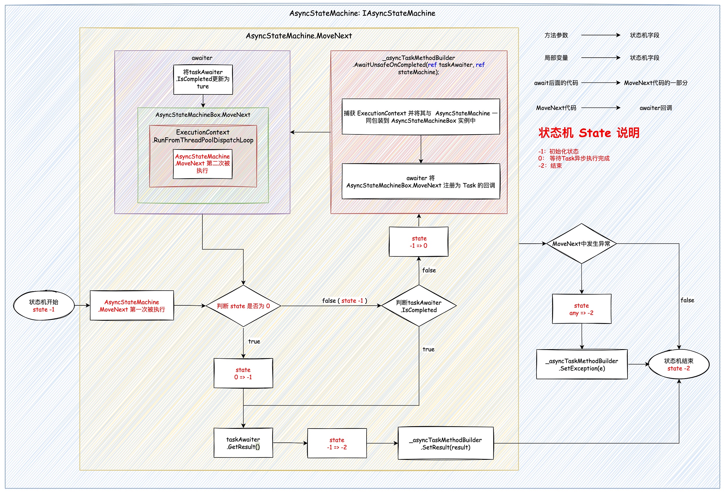

TaskAwaiter 本质上可以理解成在 await 语法糖编译成的代码中,为了解耦 Task 和状态机,而创建的一个隔离层,内部对 Task 进行了包装。
public class Task<TResult>
    public TaskAwaiter<TResult> GetAwaiter() => new TaskAwaiter<TResult>(this);

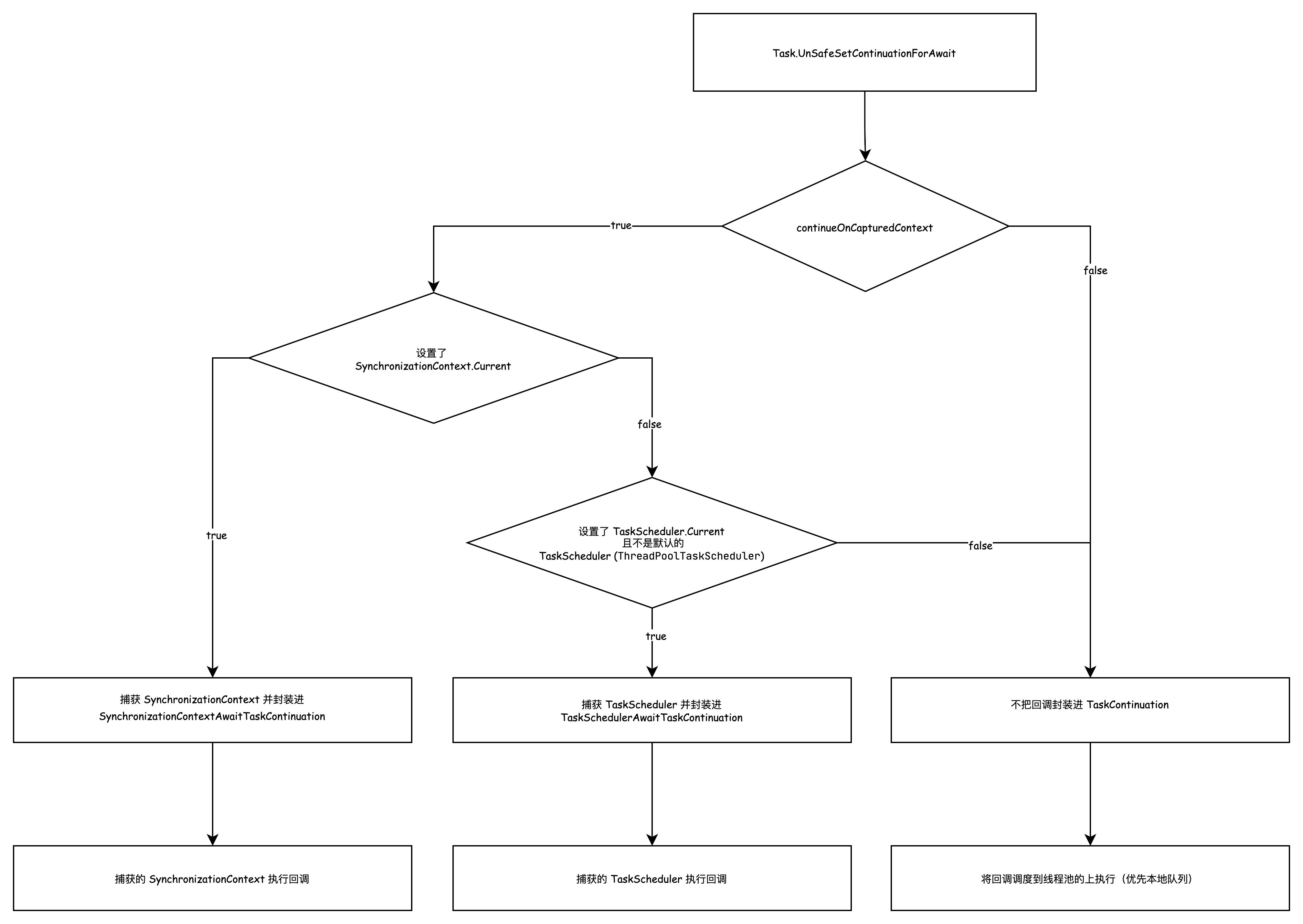

    internal void SetContinuationForAwait(
        Action continuationAction, bool continueOnCapturedContext, bool flowExecutionContext)
        TaskContinuation? tc = null;
        if (continueOnCapturedContext)
            SynchronizationContext? syncCtx = SynchronizationContext.Current;
            if (syncCtx != null && syncCtx.GetType() != typeof(SynchronizationContext))
                tc = new SynchronizationContextAwaitTaskContinuation(syncCtx, continuationAction, flowExecutionContext);
            else
                TaskScheduler? scheduler = TaskScheduler.InternalCurrent;
                if (scheduler != null && scheduler != TaskScheduler.Default)
                    tc = new TaskSchedulerAwaitTaskContinuation(scheduler, continuationAction, flowExecutionContext);
        if (tc == null && flowExecutionContext)
            tc = new AwaitTaskContinuation(continuationAction, flowExecutionContext: true);
        if (tc != null)
            if (!AddTaskContinuation(tc, addBeforeOthers: false))
                tc.Run(this, canInlineContinuationTask: false);
        else
            if (!AddTaskContinuation(continuationAction, addBeforeOthers: false))
                AwaitTaskContinuation.UnsafeScheduleAction(continuationAction, this);
public readonly struct TaskAwaiter<TResult> :
    ICriticalNotifyCompletion,
    INotifyCompletion,
    ITaskAwaiter
    private readonly Task<TResult> m_task;
    internal TaskAwaiter(Task task)
        m_task = task;
    public bool IsCompleted => m_task.IsCompleted;
    public void OnCompleted(Action continuation)
        TaskAwaiter.OnCompletedInternal(m_task, continuation, continueOnCapturedContext: true,
    public void UnsafeOnCompleted(Action continuation)
            flowExecutionContext: false);
    [StackTraceHidden]
    public TResult GetResult()
        TaskAwaiter.ValidateEnd((Task)this.m_task);
        return this.m_task.ResultOnSuccess;
    internal static void OnCompletedInternal(
        Task task,
        Action continuation,
        task.SetContinuationForAwait(continuation, continueOnCapturedContext, flowExecutionContext);
可以看到 TaskAwaiter.OnCompleted 就是往 Task 注册回调,而 await 关键词的本质就是把 await 后面的代码变成了回调并注册到了 Task 上。

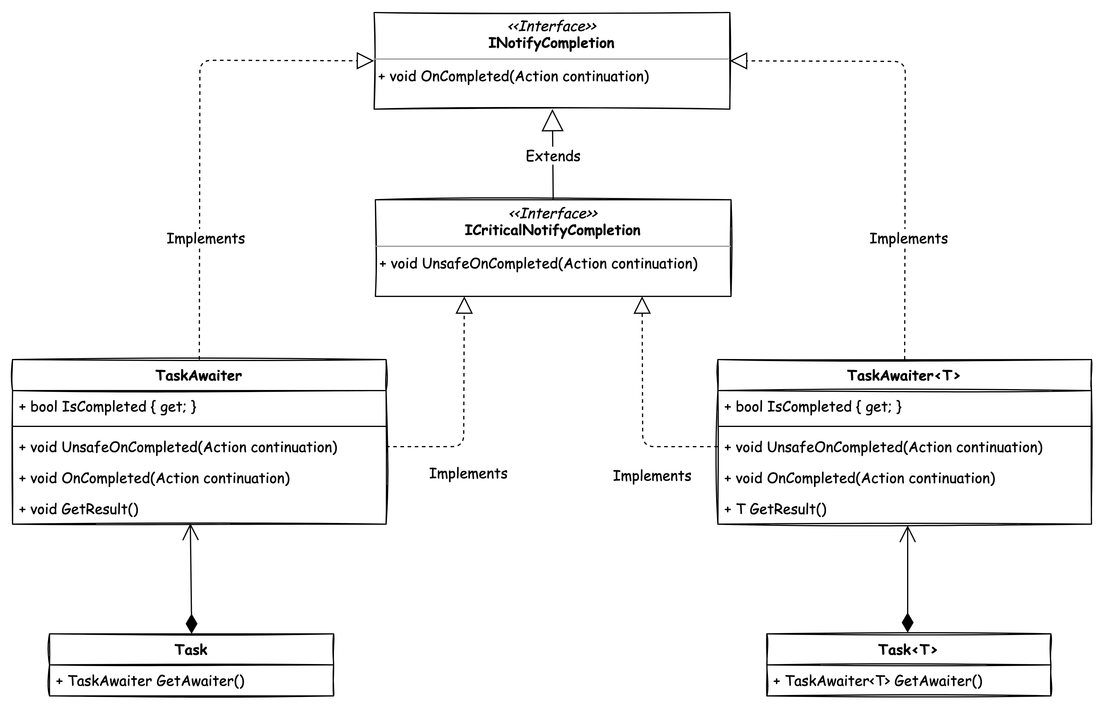

  1. ICriticalNotifyCompletion,INotifyCompletion 这两个接口。而 ICriticalNotifyCompletion 是 INotifyCompletion 的子接口。
public interface INotifyCompletion
    void OnCompleted(Action continuation);
public interface ICriticalNotifyCompletion : INotifyCompletion
    void UnsafeOnCompleted(Action continuation);
  1. 提供 IsCompleted 属性 和 void GetResult() / TResult GetResult() 方法。GetResult 方法是否有返回值取决于 await XXXAwaitable 是否想提供返回值。
实际上,我们自己想要实现一个 Awaitable 的话,Awaiter 只需要实现 INotifyCompletion 接口或者 ICriticalNotifyCompletion 就可以了。

一旦实现了 ICriticalNotifyCompletion(INotifyCompletion 的子接口),注册回调走的是 UnsafeOnCompleted 方法。如果同时实现两个方法,也还是以ICriticalNotifyCompletion 的规则优先。
INotifyCompletion VS ICriticalNotifyCompletion
既然实现 Awaitable 只要实现两个接口之一,那为什么要区分出这两个接口呢。
我们来看看 TaskAwaiter 里的实现是什么样。
public readonly struct TaskAwaiter<TResult> : ICriticalNotifyCompletion, INotifyCompletion
    internal TaskAwaiter(Task<TResult> task)
        m_task = task;
        TaskAwaiter.OnCompletedInternal(m_task, continuation, continueOnCapturedContext: true, flowExecutionContext: true);
        TaskAwaiter.OnCompletedInternal(m_task, continuation, continueOnCapturedContext: true, flowExecutionContext: false);
        Task task,
        m_task.SetContinuationForAwait(continuation, continueOnCapturedContext, flowExecutionContext);
OnCompleted 和 UnsafeOnCompleted 的唯一区别是在调用 TaskAwaiter.OnCompletedInternal 时,flowExecutionContext 这个参数有所不同。
ExecutionContext 的本质是一个线程私有变量,维护着我们常用 AsyncLocal 的数据,例如 Thread.CurrentThread.CurrentCulture 其实就是一个 AsyncLocal 变量。
runtime 中会在发生线程切换的地方,将 ExecutionContext 从前一个线程拷贝到后一个线程。那么第二个线程里也就可以拿到在第一个线程里设置好的 AsyncLocal 变量。
就算线程没有发生切换,runtime 里有的地方也会通过清空 ExecutionContext 来阻止其往后传播。
更多 ExcutionContext 和 AsyncLocal 的解析,请参考我之前的一篇博客:
https://www.cnblogs.com/eventhorizon/p/12240767.html
也就是说 OnCompleted 会保证 ExecutionContext 往后传播。而 UnsafeOnCompleted 则不会。我们来看下面这个示例。

如果像上文那样自己实现 Awaitable,会调用 TaskAwaiter.OnCompleted 或者 TaskAwaiter.OnCompleted 方法。这个和 AsyncMethodBuilder 内部的实现有关。(手动狗头,设计的太复杂了)

观察下面这么一个常见的 await 使用场景,可以将 FooAsync 方法内部的逻辑分为三种状态(即 三个阶段):
  1. 初始化状态
  2. 等待 BarAsync 执行完成的状态
  3. 执行结束状态
class Program
    static async Task Main(string[] args)
        var a = 1;
        Console.WriteLine(await FooAsync(a));
    static async Task<int> FooAsync(int a)
        int b = 2;
        int c = await BarAsync();
        return a + b + c;
    static async Task<int> BarAsync()
        await Task.Delay(100);
        return 3;
由 FooAsync 编译成的 IL 代码经整理后的等效 C# 代码如下:

编译器在 Program 中创建了一个内部类,也就是 FooStateMachine 这个状态机,而 FooAsync 方法则变成了对这个状态机的使用。
AsyncTaskMethodBuilder 的作用解释放到下一篇文章再解释,这边简单理解成 AsyncTaskMethodBuilder.SetResult 就是 FooAsync return 返回值,AsyncTaskMethodBuilder.SetException 就是 FooAsync 内部往外扔异常。
完整的流程如下图所示:
一个方法中就算有个 await,这个方法也只会有一个对应的状态机。就.NET 6 SDK 的编译结果来看,state 会出现 -1 => 0(等待第一个Task异步执行完成) => -1 => 0(等待第二个Task异步执行完成)这样的流程。
AsyncStateMachineBox
前文讲过 awaiter 往 Task 注册回调的逻辑里,可能不会直接传递 ExcutionContext。
而这个 AsyncStateMachineBox 是对 AsyncStateMachine 和 ExcutionContext 的包装,这边通过这样的方式往后传递 ExcutionContext。
await Task 的回调在哪执行
回忆一下上文 Task.ContinueWith 讲回调最终封装到了 ContinueWithTaskContinuation。
返回值是 Task 的情况下状态机所绑定的 AsyncTaskMethodBuilder 的所会调用 Task.UnsafeSetContinuationForAwait 实例方法。里面会根据不同的条件创建不同的 TaskContinuation。
UnsafeSetContinuationForAwait 中的逻辑和后续回调执行流程大致如下:
值得注意的是,当前上下文设置的 TaskScheduler 并不能通过 TaskScheduler.Current 获取,而应该通过 TaskScheduler.InternalCurrent 获取。

同步上下文(SynchronizationContext)导致的死锁问题与 Task.ConfigureAwait(continueOnCapturedContext:false)
如果存在 SynchronizationContext,回调会优先在 SynchronizationContext 上执行。而 SynchronizationContext 也是一种任务调度器,其存在时间应该是早于 Task 的。
在 .NET Framework 时代的 WPF、Windows Form、Asp.NET Web Form 这些框架里,都有 SynchronizationContext 的存在。
下面是一个 SynchronizationContext 的实现示例:
